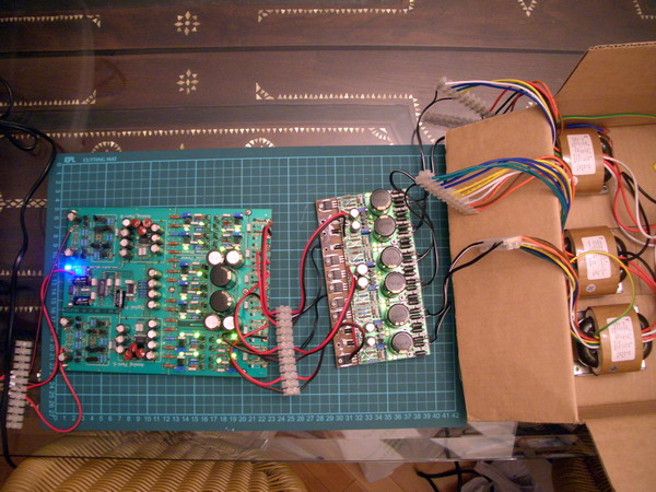

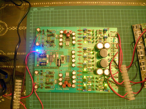

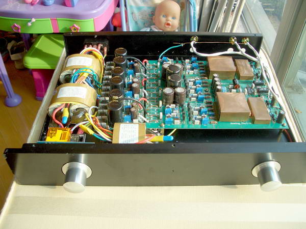

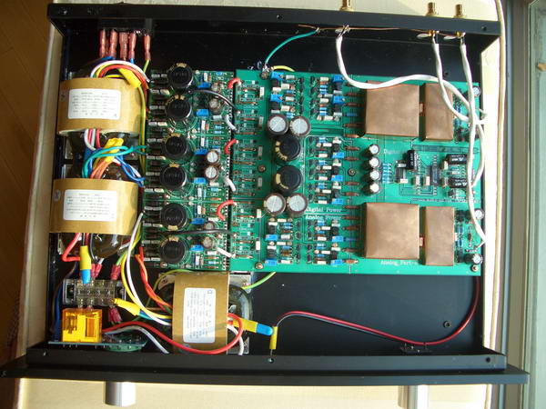

作者:mwpmo (203.xxx.xxx.109) 發表主題:44 回應文章:393 日期:2005-07-19 08:49
I have completed DAC19 last night.
More photos have been uploaded in http://diy.tower3a.com
Next Step - Enjoy Music !!!.

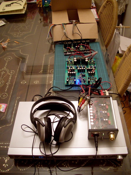

作者:mwpmo (218.xxx.xxx.183) 發表主題:44 回應文章:393 日期:2005-07-12 10:12
I have tested DAC19 last night.
冇用交連電容, DC in analog out is about 25mV (at PCM1704U-K DAC out is 0.8mV)
In my opinion, the bass and the "dynamic" is better than my AW-D2.
More details can be heard.
At first, I just plan to test it for a few mins but at this end, I listen it for nearly two hours (until the battery in my PPA headphone dead).
Next Step - Installed copper shielding box to shield the dac chips and the I/V module

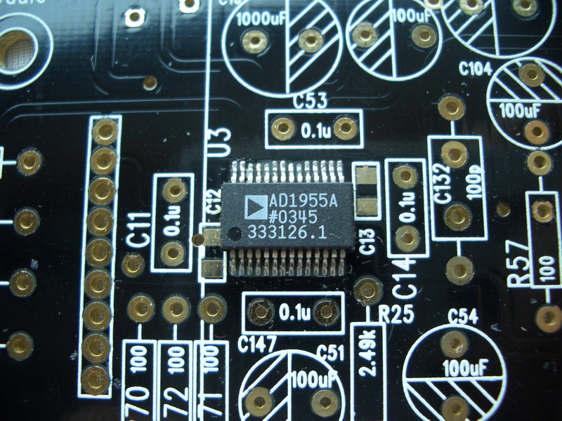

作者: mwpmo (202.xxx.xxx.147) 發表主題:44 回應文章:393 日期:2005-02-04 16:46

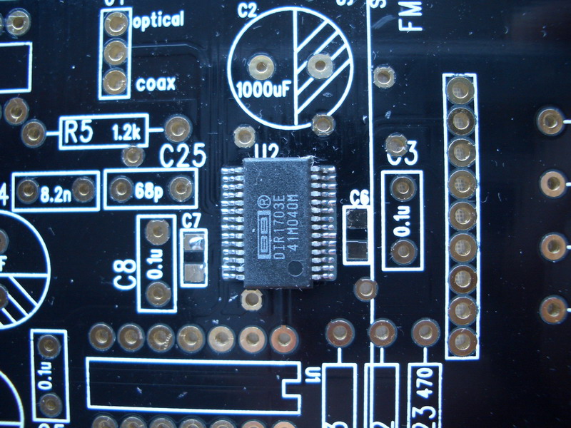

After my DIY CD Player was completed, I started my new DIY project.
A DAC with Burr-Brown DIR1703 數碼接收晶片 and Analog Device 的頂級DAC - AD1955 解碼晶片
