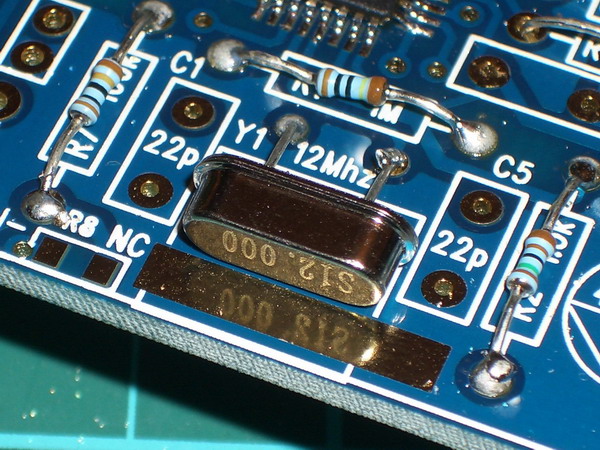

作者:mwpmo (203.xxx.xxx.109) 發表主題:44 回應文章:393 日期:2005-03-09 20:59
The S12.000 is the clock (12MHz) for the PCM2706.
I don't know the case in your soundcard.
But in PCM2706, there is a built in PLL circuit to lower the jitter.
In addition, unlike the case in normal DAC that received SPDIF data from CD/DVD, the data received is from the USB bus and the USB protocol have built in error correction.
A higher quality clock like the Pure CLock I use in my CD-Pro2 will not increase the audio quality of this USB DAC.
作者:Duckduck (218.xxx.xxx.139) 發表主題:34 回應文章:339 日期:2005-03-09 20:09
mwpmo,
What is this (S12.000) and its function? I found there is similar thing in my sound card.
Is it critical to sound effect?
