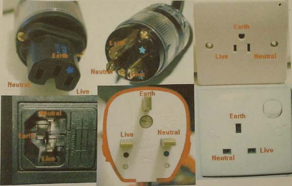

作者:Tequila (66.xxx.xxx.60) 發表主題:26 回應文章:1244 日期:2006-06-02 16:06
HumanPower Hing, are you sure what you are talking about?
IEC320 is a electric standard and the picture correctly shows the wiring. If you open up any industry standard IEC plug, it clearly stated which "leg" is the Live, which is Neutral and Earth. You know the reason? Because protection device such as fuse or circuit breaker in each equipment should be wired on the "Live" side.
Same principle applies to US and UK plugs (UK is obvious because it has a fuse inside). All these plugs have clearly stated which is Live, Neutral and Earth and the picture again is correct.
All products that use the "multi-system" plug HAVE the same problem. If this is wired as UK, it would be wrong for US plug (and power cord). If this is wired as US, it would be wrong for the UK.
So far I have only touched the electrical wiring correctness, haven't event talked about sonic difference. Sonically, most machine sound proper when wired correctly. However, there are some exceptions where machines sound better when wired out of phase (or polarity).
作者:humanpower (221.xxx.xxx.47) 發表主題:90 回應文章:2622 日期:2006-06-02 01:14
TEQUILA兄:
你幅圖左下角及左上角的兩張是錯的,
每部機身上的插座都會有唔同相位,
iec頭亦然,
所以這兩張圖是錯的.......

作者:P.Yeung (219.xxx.xxx.117) 發表主題:53 回應文章:1144 日期:2006-06-01 10:57
If it is using those "multi-system" type sockets, the "phase" (or the "polarity") can only be right in one way as US and UK sockets are oriented differently. That is also one of the reasons why such sockets are in violation of HK's eletrical code.
Cheers! PKY
