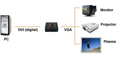

是的現時很少dvd出720p&1080i用模擬訊號.多數dvd出720p&1080i是用數碼輸出的.而crt tv是用rgb v/h的 所以祇能接收模擬訊號.市面可對應的dvd機可用色差出720p&1080i的首推選為 skyworth hvd 3050是一個不錯撰擇.而這個轉換器(三槍恩物)也值得試吓

Most DVD player only output 720P/1080i via digital out. In that case, the CRT user can't utilize this upscale advantage. Using this converter, CRT user can get 720P analogue from the existing DVD players. They can save money to buy video processor with 720P analogue out. Of course, upto this moment, the performance of DVD players are still not as good as decent video processor.

crt 吾係只收anolog訊號咩,點解吾直接vga to vga,咁樣dvi轉vga吾係會有失真嗎?
就好似lcd 數碼接數碼會最好

The signal path of component and DVI are different. Component will pass through the DAC while DVI won't. The DAC chip provides the picture adjustment and adds some video processing. Most people said the component out having richer colour than digital out.

Happy to see that you had a good result with the convertor. However, I tried it with my Barco Cine 7 LT with A11(DVI to RGBHV), I found that the color was not as rich as component (althought the picture was smoother), do you have the same problem? Some people said it is due to the A11's DVI output has less color than it's component out, is that true?

If your CRT can intake 720P/1080i via VGA, then it should be fine.

這轉換器很有興趣.我是用先鋒969和sony kv-hr36電視的.969是用hdmi的.請問如加這個 dc-da1可否用hdmi轉dvi轉插去dc-dai再vga出去sony的hr36電視.因sony有rgb-v/h可以上到720p&1080i的.謝謝 ckl兄可否解答一吓

I'm 現在測試一。我的Epson TW200H 1280x720 LCD 放映機有只15pin VGA 輸入, 沒有DVI/HDMI 。我的通常連接是從我的HTPC 6M Canare 15pin-5BNCs(M) 到2M Canare 5BNCs(F)-15pin 對放映機。現在我使用一便宜的粗劣6M DVI-D-DVI-D 纜繩從HTPC 對DVI-VGA 交換器, 那麼塞住VGA 末端直接地在放映機! 談最短的模式道路! 並且I haven't 用途力量適配器。以確切的設置在HTPC 和放映機, 交換器產品是非常熱的! 白色水平嚴重被截去。我需要減少projector's 被輸入的白色水平相當得到正確水平作為通常指揮15pin 連接。雖然您CRT 放映機用戶可以愛熱的產品! 整體圖片優秀。它似乎更多提煉仍然位元軟性。它至少是像以前一樣。需要做更多觀察雖則。真正的測試將來當我測試它與那些最近upconvert DVD 機譬如Marantz 9500, 先驅59avi, Denon 3910/2910 等在一臺CRT 放映機在1080i/720p, 在幾天。以後。問候, 李
http://www.avsforum.com/avs-vb/showthread.php?postid=4989168#post4989168
這條螺紋似乎死! 如果我們會繼續談這"thing"? 無論如何, 嘗試箱子與Marantz 9500 DVD 機。10M HDMI-DVI 到箱子和15pin VGA 使用通常連接(大約6M VGA-5BNCs 纜繩在HTPC 被設定) 與索尼G70 放映機。我們嘗試了唯一720p 方式。箱子確切地輸出了時間作為HTPC 在720p 並且G70 自動地選擇同樣記憶。在某一AVIA 以後brightness/contrast 在DVD 機, 我們得到了一張正派圖片。美好的決議(AVIA 決議和鋒利, Y/C 延遲樣式看起來完善), 優秀顏色和固體和3D 圖片。第一次我們don't 需要DVD 機對pillarbox 4:3 內容如同我們能改變長寬比在放映機! 我們觀看了許多夾子和有□什麼抱怨(除DVD 機的粗劣的pulldown 偵查和錄影deinterlace 以外!) 。這簡單地有效! 然後我們嘗試了交換器在HTPC (ZoomPlayer, Nvidia 譯碼器, FFDShow 等), 簡單地為嘗試! 6M DVI-DVI 然後通常15pin VGA 連接。圖片是驚人! 鋒利和決議和拳打吹了Marantz 去! 哇, 設定從未神色好! 然後我們去除了箱子和回到原始的直接HTPC 15pin VGA 對放映機。圖片回到了好老形式以更軟和更加昏暗的口氣。錄影噪聲更加高級是比交換器在鏈子。現在G70 can't 居住沒有交換器, 在是的HTPC! Btw, 那裡是沒有白色易碎問題在G70 與交換器在道路和沒有改變任何個設置。它似乎白色夾子問題實際上歸結於我的LCD 放映機。問候, 李 PS: 交換器真實地是令人驚訝的! 在所有測試以兩最終用途長的纜繩, 我們didn't 用途包括的力量適配器和它工作以大獲成功!

I think the performance of this convertor is quite good. At least there is no negative effect after the digital signal is converted to analogue.
