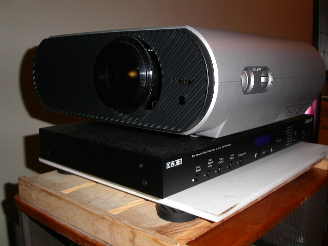

CKL, So are saying that not the HDMI input for 720P is actually some other resolution say 768*1388, because it can be fixed by Iscan HD?
作者:CKL (61.xxx.xxx.151) 發表主題:104 回應文章:3438 日期:2005-05-26 12:09
Hi Phat,
We tested HS50 with HTPC and 720P DVD player. Yes, it can't get 1:1 mapping of 720P at HDMI but VGA input is OK. AVS member report that Iscan HD can do 1:1 mapping with HS50. We will verify it later.

作者: Phat (210.xxx.xxx.114) 發表主題:17 回應文章:53 日期:2005-05-26 11:56
CKL & Li-On,
I have rainbow eyes and the best LCD at under $30,000 is the sony HS-50. But after seeing your review on BUZZ & doing a search on AVS forum, I found the problems with HS-50's HDMI input is not solved yet (well at least in the US). There's 2 types of thoughts:
1) The original HDMI output of 720P with blackborder was actually P-to-P.
2) The new firmware/updated version was just rescaling the incorrect mapping to fit the output window, in other words, Not fixing the problem!!
So do you have a chance to check on the updated/newer versions of HS-50. Any idea what the situation is like in HK, because the sales are very reluctant to talk about them. Please Help!!!!!
