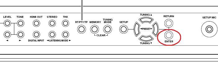

作者:ken chiu (220.xxx.xxx.193) 發表主題:4 回應文章:150 日期:2008-02-20 10:45
Hi Good2007,
the "Enter" key is just located as the pic shown...
作者:good2007 (220.xxx.xxx.202) 發表主題:1 回應文章:24 日期:2008-02-20 10:16
Dear Benja Hing,
I have the problem in updating too. I am not quite understand what press Enter means in the procedure file. I unpluged the AC power of the receiver and connect the RS232 with my laptop to the Amp. Turn on the power of the Amp. Then I should see the MainupdateMode message displayed. After that to unzip the update file and so on.
I don't have luck to see the MainupateMode appeared. Would you mind telling me which step i ran in problem.
Thanks
