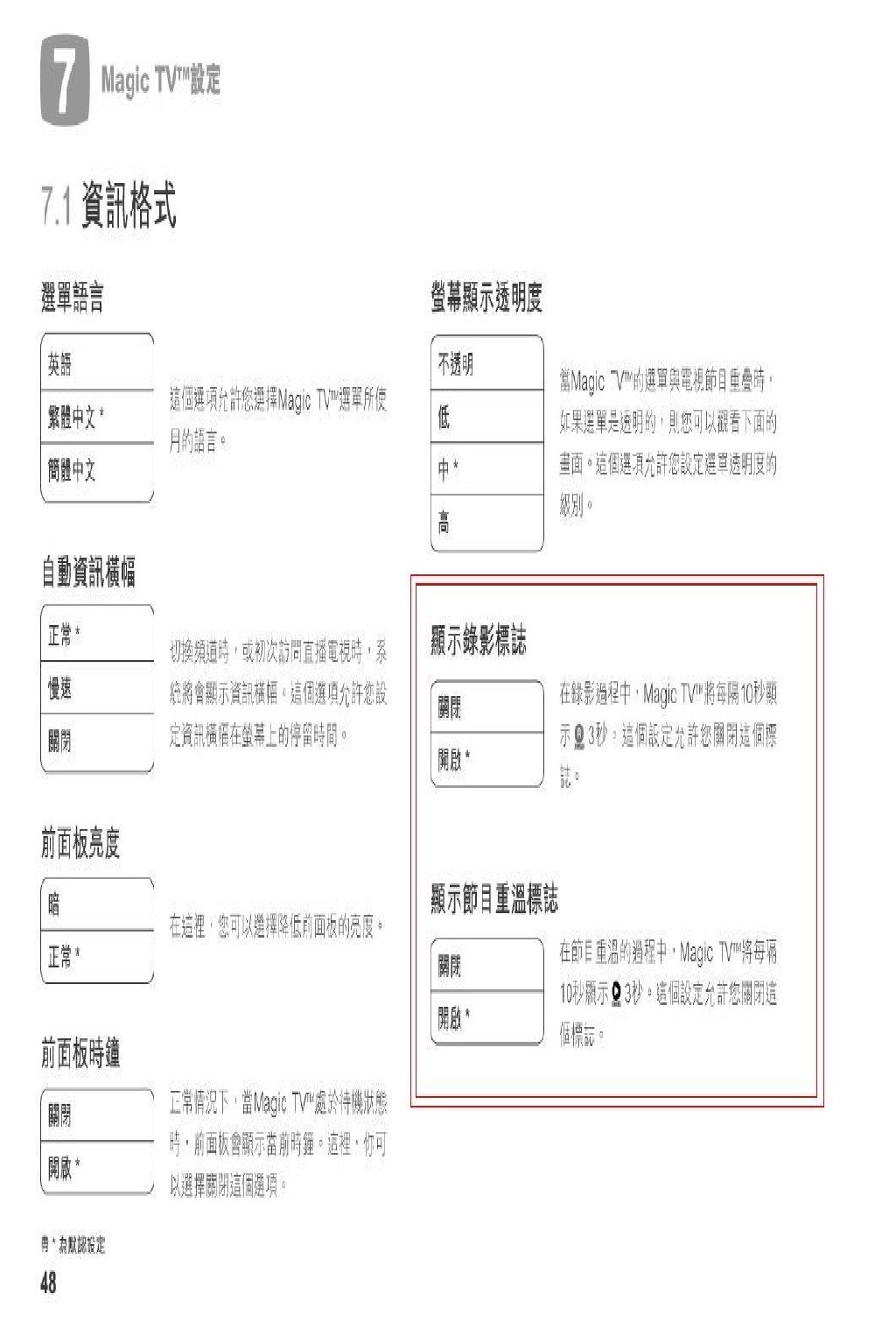

"Li On ¥S»P¦U¦ì®v¥S:
MTV3000 ·s¤â, ®Õ©w®É¿ý¼v«áº¶¾÷, °÷ÄÁ¦Û°Ê覑¾÷, ¦ý¹qµøµe­±·|¥X²{¤@¥y
'¿ý¼v§¹¦¨«á, ¨t²Î±N·|«Ý¾÷'¡C
°Ý¥i§_¨ú®ø¦¹Åã¥Ü¡H"
§@ªÌ¡Gdchi (202.xxx.xxx.129) µoªí¥DÃD¡G0 ¦^À³¤å³¹¡G5 ¤é´Á¡G2008-07-23 16:05
Li On ¥S»P¦U¦ì®v¥S:
MTV3000 ·s¤â, ®Õ©w®É¿ý¼v«áº¶¾÷, °÷ÄÁ¦Û°ÊþÓ¾÷, ¦ý¹qµøµe­±·|¥X²{¤@¥y
°Ý¥i§_¨ú®ø¦¹Åã¥Ü¡H

§@ªÌ¡Gahkeung2003 (203.xxx.xxx.171) µoªí¥DÃD¡G3 ¦^À³¤å³¹¡G114 ¤é´Á¡G2008-07-23 13:14
here
§@ªÌ¡GGodfrey Lau (202.xxx.xxx.47) µoªí¥DÃD¡G0 ¦^À³¤å³¹¡G16 ¤é´Á¡G2008-07-23 11:53
Aderr Hing,
¥¿¦b¿ý¼v/­«¼½ display°{°{¤U«Y¥i¥H响³]©w¤J­±Ãö咗Ê\¬[Ø{¡C

§@ªÌ¡GIShin (219.xxx.xxx.250) µoªí¥DÃD¡G0 ¦^À³¤å³¹¡G83 ¤é´Á¡G2008-07-23 02:05
§Ú³£·Qcomment ¤U ¥¿¦b¿ý¼v/­«¼½ display
°{°{¤U¯u«Y­øµÎªA
§Úı±o¦n¦ü¤H¦a¹qµø¥xËÝ
¡u¸û¦­«e¿ý¼v¡v«Y¥ÑÀY³£§À³£show
´N´X¦n³â
http://mtvlab.blogspot.com/
