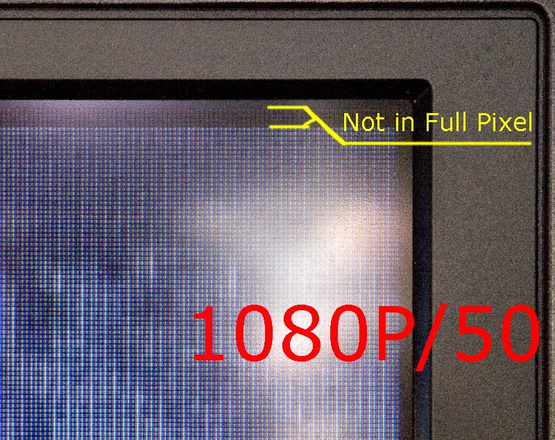

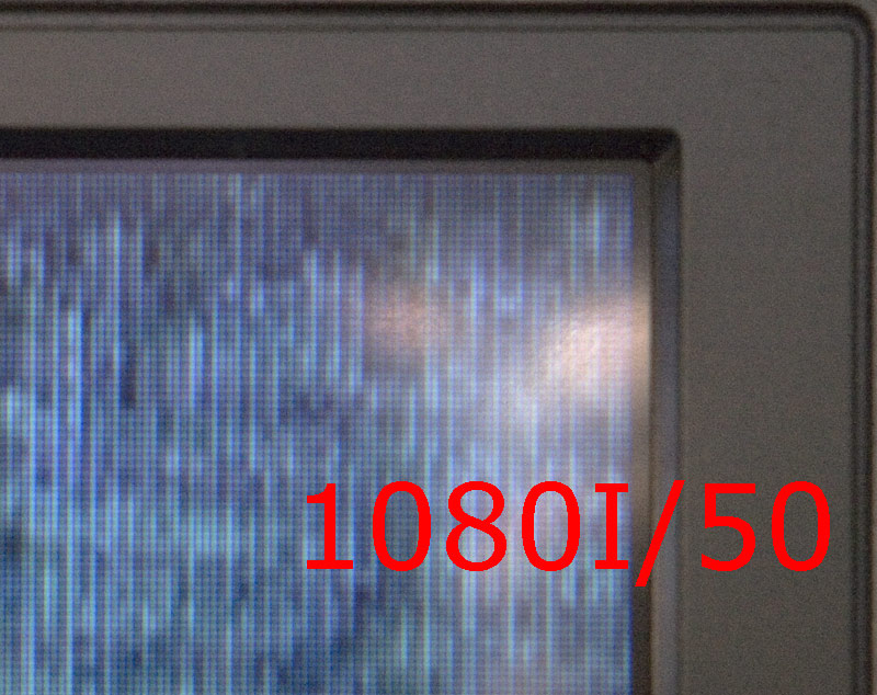

作者:smallkeung (210.xxx.xxx.106) 發表主題:9 回應文章:81 日期:2008-07-22 10:00
Hi Li On,
It is same TV programme - HD Jade Miss Hong Kong and same TV setting, is that wried?
By the way, I will check all setting clearly. I will try the Test pattern tonight and report here later.
Thank you ~ Li on.
作者:Li On (125.xxx.xxx.236) 發表主題:103 回應文章:1065 日期:2008-07-22 09:49
smallkeung hing, you see un-used pixel because in 1080p you're running 1:1 mapping from the MTV3000 to your 1080p TV. On your Sony, select Wide Mode: FULL, in Settings->Screen->Display Area, select Full Pixel. On the MTV3000, goto Setup->Video->Test Pattern, you will see the FULL 1920x1080 pattern with all the 4 sides edge lines. This is 1080p 1:1 mapping. The MTV3000 outputs the full 1920x1080 pixels and the Sony will display all the 1920x1080 pixels.
BUT, there is NO guarantee that the TV station will always use the FULL 1920x1080 pixels in ALL programs. If you do not like there is some un-used image area in some program, please complain to the TV station.
Or, you can enable OVERSCAN on the TV. On the Sony, under Settings->Screen->Display Area, select Normal (2% overscan), -1 (3% overscan), -2 (4% overscan) to slightly ZOOM the image and cut off any un-used image area in image edge.
If you want 1920x1080 in 1:1 mapping, sometimes there will be some un-used pixels around image edge, unless you can talk to TV station and force the broadcast to ALWAYS USE ALL THE 1920x1080 PIXELS IN ALL PROGRAMS!
It's sad that MOST people still can not understand these concept...
regards,
Li On
作者:smallkeung (210.xxx.xxx.106) 發表主題:9 回應文章:81 日期:2008-07-22 09:45
TO: J Wong
If the photos are in same programme, is that wried?
*The photos are took from a recorded programme - HD Jade - Miss Hong Kong. I puased and took photo
作者:J Wong (202.xxx.xxx.113) 發表主題:37 回應文章:202 日期:2008-07-22 09:26
Hi Smallkeung,
My Sony x300A also show 4 pixels lower in 1080i50Hz mode but it really depends which programme we watching (even in HDJade.)
JWong
作者:smallkeung (210.xxx.xxx.103) 發表主題:9 回應文章:81 日期:2008-07-22 02:09
Hi Li on,
I have found another issue for 1080P/50Hz output. It doesn't show in full pixel. The screen shows 4 pixels lower. But the 1080I/50Hz doesn't have any problem. Please help to report and fix.
I have attached 2 photos for your reference.
*My TV is Sony x300a
Thank you very much!
