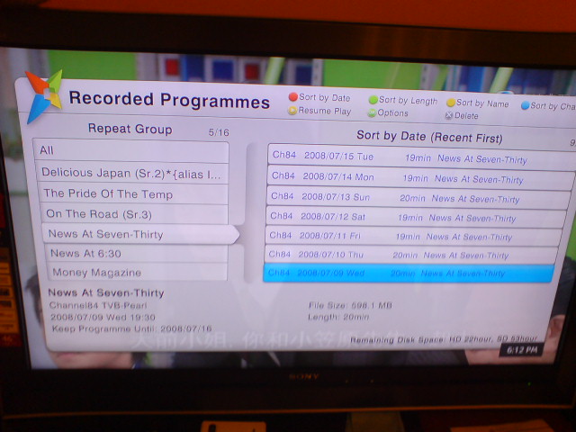

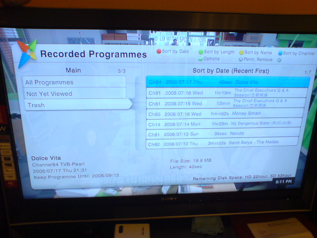

作者:hd-mania (202.xxx.xxx.117) 發表主題:0 回應文章:16 日期:2008-07-18 18:08
PeterLie hing,
Thanks for prompt reply.
About yr suggestion, actually I did, but it simply could not be moved to trash.
My MTV3K is always \"standby\" until I watch TV.
BTW, could MTV3K menu add an option so that we could forcefully sweep the outdated programmes to trash.
作者:PeterLie (125.xxx.xxx.236) 發表主題:0 回應文章:133 日期:2008-07-18 17:11
hd-mania hing,
Please find one programme in the Recorded Programme List that has a "Keep Programme Until:" date that is yesterday or earlier. Standby the Magic TV, and wake it up again. Please check that the programme has been moved to Trash.
Even if you do not standby the Magic TV, this housekeeping operation will also be carried out daily, or when you run out of disk space for recording.
作者:hd-mania (202.xxx.xxx.117) 發表主題:0 回應文章:16 日期:2008-07-18 13:33
MTV3K has a housekeeping feature to help you discard obsolete program.
However, when I setup to keep some programme no loner than 1 week, I found those more than 1 week long still remains and would neither be automatically deleted nor put in the trash folder.
I wonder if it is bug of MTV3K firmware or I got something wrong.
This is one of the valuable features that appeals to me because I need not spend time to manage programme one by one. Anybody could help?!
