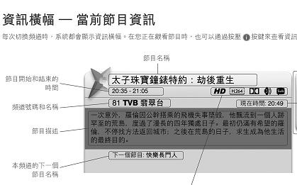

作者:milklok (221.xxx.xxx.188) 發表主題:0 回應文章:8 日期:2008-06-29 23:18
Sorry I forot the mention that other brother in other forum say that they can see that info in the EPG of the program 奧運巨星逐個捉 of ATV using a computer program called DVBViewer, But I cann see the program description usng my MTV3000
作者:celsius (61.xxx.xxx.80) 發表主題:6 回應文章:431 日期:2008-06-29 23:15
The program information has nothing to do with any STB.
It is provided the TV station.
If TV station does not broadcast any information, STB cannot show it.

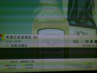

作者:milklok (221.xxx.xxx.188) 發表主題:0 回應文章:8 日期:2008-06-29 23:12
I am talking about the following info screen.
作者:milklok (221.xxx.xxx.188) 發表主題:0 回應文章:8 日期:2008-06-29 23:11
Hi Li on hing,
I like the interface of MTV3000 very much. Much better than other STB.
I am using new 2.0 Beta Firmware, I cannot see any 節目描述 in the information. Is is a bug in the new firmware? Thx!
In addition, during 1080p (50Hz and 60Hz), the Logo of HD TVB has vibration and the screen become slow when the video is panning (fast moving). Hope this will fix in new firmware.
I have a comment, too. During the EPG list, when user press OK a dialog "EPG Recording Option" will show. I suggest to add "Go to this channel" so that I can go directly to that channel if i interest in that programme.
