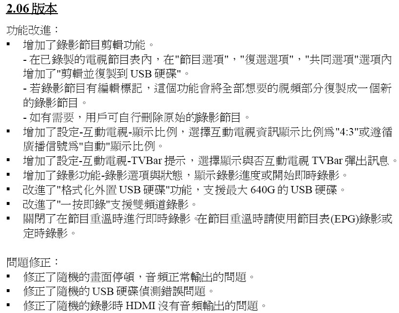

The Editmark function is in firmware 2.05 a month ago. If user used Editmark, then using 2.06, a simply "cut" all programs will do the job. Though a little time and space is needed...

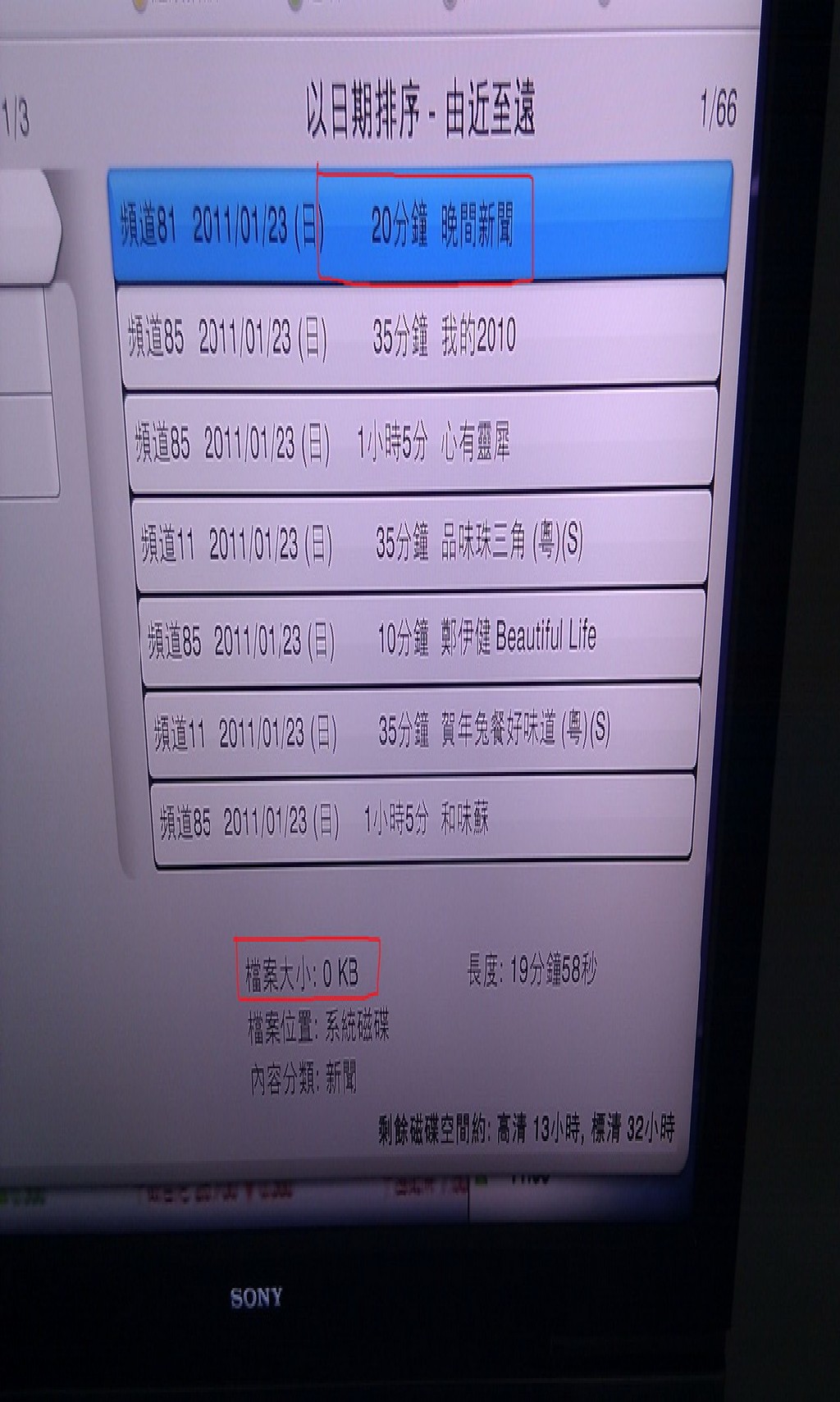

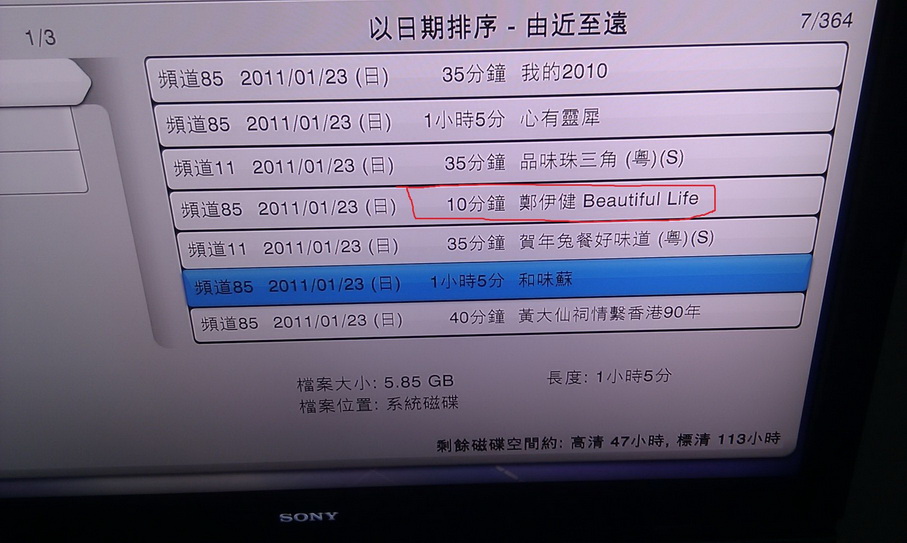

Eddie Wan hing, 10mins difference maybe too little to reflect on the total remaining time.
You can do a test, for example, take a longer (1.5 or 2hours) HD recorded program, delete it (move to trash). The recording time should increase.
Un-delete the program, and mark MOST of the recording as unwanted and make a cut program of just a few minutes.
Then delete (move to trash) the original long recording. The recording time should increase.
After the test you can undelete the original recording, remove the editmark, delete the short "cut" clip and return everything to normal!

I just tried to work it out for a recorded programme. It took about 10 muinutes to copy the original edited programme of about 30 mnutes to a new one. As someone has mentioned, the capacity of the harddisk for further recording did not change after the original programme is deleted. Is it just a small bug?

What the new editing function does is to "record" a playback.
You edit a recording by "marking" the unwanted portion and then make a recording by playing back the edited recording.
Therefore it takes as long as the resulting recording. i.e. about 42 minutes from a TV program after skipping the adverts.
It takes one more step and a lot longer than what DVD HDD recorder does.
But it does work and work satisfactorily. It is a clever and simpler way to make that possible until a new software can be written like a DVD HDD recorder does.
