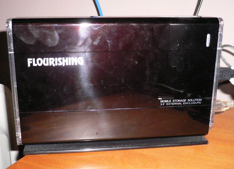

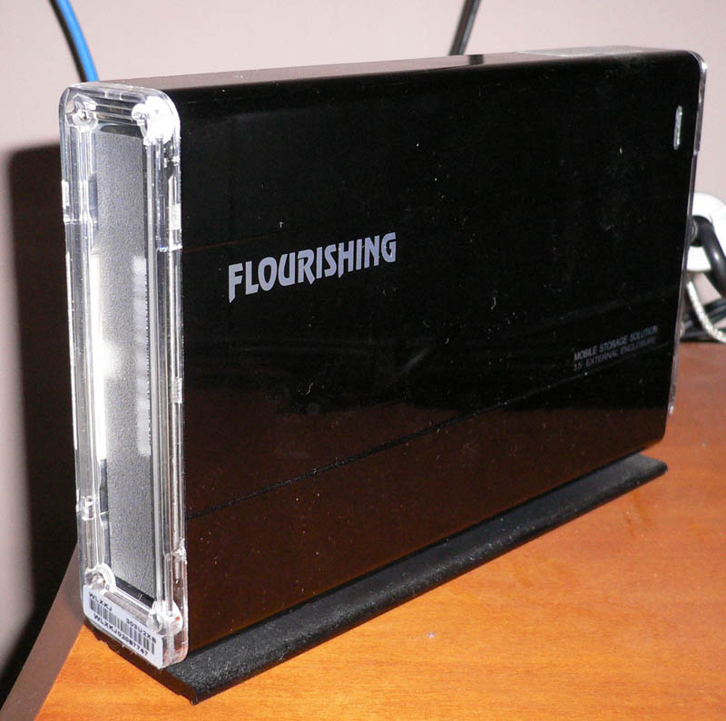

作者:P.Yeung (58.xxx.xxx.246) 發表主題:53 回應文章:1144 日期:2008-08-09 02:08
>hi P.Yeung
>can you upload the external HDD box pic for reference?
I bought it at Wanchai 298 mall.
Cheers! PKY
