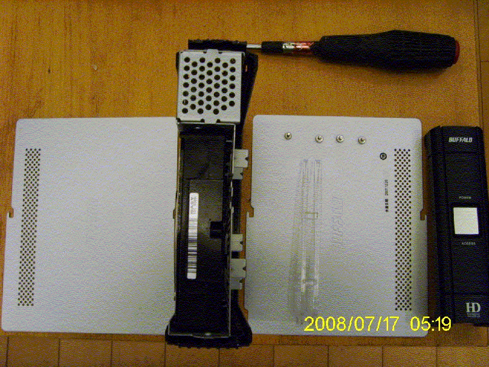

作者:Peter 佬 (218.xxx.xxx.50) 發表主題:0 回應文章:20 日期:2008-08-06 19:42
Hello sman
Thankyou for your question which correct my post.
We need to pull out the left & right aluminum plate and the plastic stick first then pull out the hard disk but it is easy.
I do not have steady hand o take clear picture.
You may find picture not clear.
Regards

作者:sman (219.xxx.xxx.220) 發表主題:29 回應文章:1145 日期:2008-08-06 18:30
HI Peter,
"Afterwards just use 2 fingers to pull out the hard disk and insert another one"
Is it easy to replace HD? Do you have photo to demonstrate the action? thks

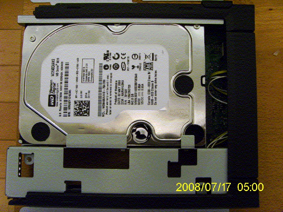

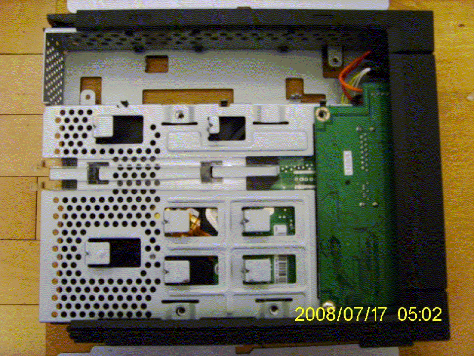

作者:Peter 佬 (218.xxx.xxx.50) 發表主題:0 回應文章:20 日期:2008-08-06 18:17
Hi All Bros
One of our bros stated that the hard disk inside the Buffalo 500G is Seagate long time ago. His mention ignites my interest to change the hard disk inside.
Therefore today I use the Buffalo 500G as a removable hard disk case.
Please do not mind I try to share with all yours.
Tear off the maintenance guarantee sticker, unscrew the covered screw ( this screw is different from those used to fixed the hard disk ), lift away the front black frame ( the front panel with silver transparent plate allows red and green light out ), pull out the aluminum plate on both left and right side, pull out the long transparent plastic stick genteelly ( this stick transmit the green and red light, there are a small 凹凸 spot to kept it in position ), unscrew those screws which fixed the hard disk, pull out the Seagate hard disk, insert another hard disk ( I insert the Western Digital 640G 16Mb buffer WD640KS16 cost HK$630.00, may be you consider Seagate 640G 32Mb buffer cost HK$700.00 which mention by $10.00 CPU magazine issue 142 page 12 but no model number ), insert back the long transparent plastic stick, insert back the left and right aluminum plate, cover back the front panel.
The whole item working normal even those green and red light also working normal.
Afterwards just use 2 fingers to pull out the hard disk and insert another one.
I use this method to save money.
It is no doubt that buy more brand new Buffalo is simple & easy but cost you more.
Best Regards

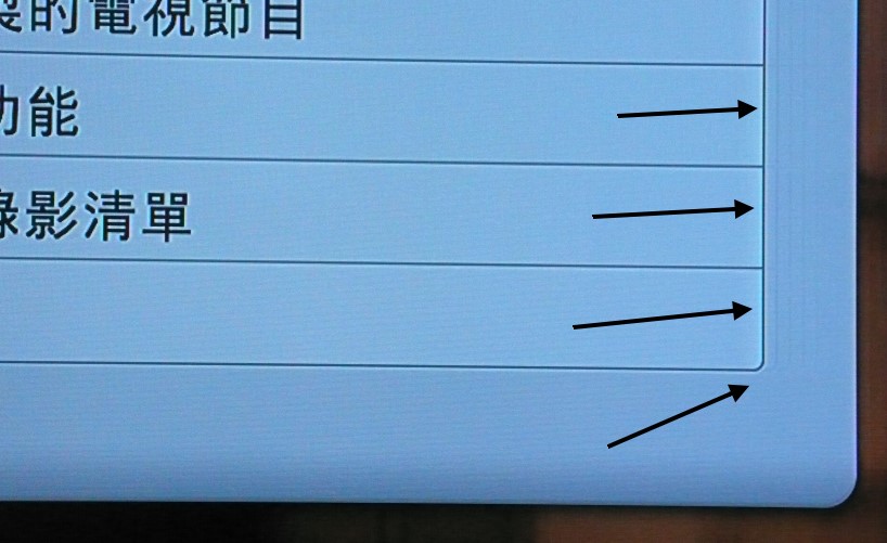

作者:wallE (203.xxx.xxx.177) 發表主題:0 回應文章:1 日期:2008-08-06 15:26
我的MTV3000出現間歇性鬼影 (連高清台及MTV3000的set-up page也有---見下圖箭咀所示), 叫過電視機公司check, 結果話唔關電視機事, 叫我check下部MTV3000, 結果帶埋部機問豐澤, 試機時也有同樣情況, salesman再試下部Demo機, 情況更壞, 結果拿部新機出黎試, 情況也一樣有間歇性鬼影.
請問各位有沒有遇過同樣情況?
