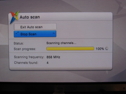

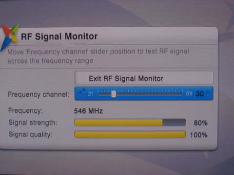

作者:PeterLie (221.xxx.xxx.195) 發表主題:0 回應文章:133 日期:2008-08-01 23:59
Floss brother,
1. Please use the signal monitor to check 586MHz (Freq Ch.35) and 602MHz (Freq Ch.37). You'll need to wait for at least 10 seconds after changing the frequency every time.
2. You may need to adjust the angle of the fishbone antenna by checking the signal at 586MHz. The fact that you can receive 546MHz does not necessarily imply your antenna is already at the perfect angle. See if you can adjust the antenna such that the signal quality of 586MHz remains at 100% at all times. Since the antenna is on the roof, you may need a friend to help you.
3. If the contact among the signal booster, antenna and cable is not good, it will add noise to the signal and prevent you from receiving a good signal. In other words, if not done well, the signal booster and the cabling can seriously affect digital TV reception.
4. Some types of signal booster amplifies a specific range of frequency only, leaving out the 586MHz and 602MHz that you need.
5. For experiment only, you may also try to put the fishbone antenna in your home instead of the roof, point it outside through the window (if the angle is correct), and directly connect the antenna to the Magic TV using a coaxial cable, without the signal booster.

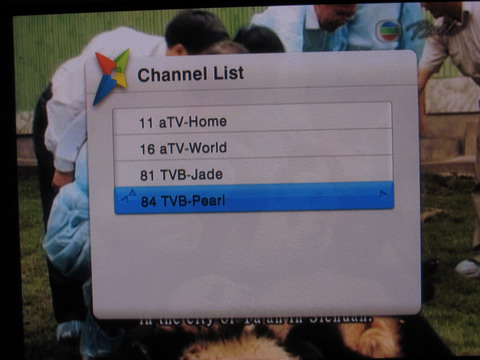

作者:Floss (203.xxx.xxx.207) 發表主題:0 回應文章:1 日期:2008-08-01 20:42
Hello to everyone here
I decided to buy the MTV-3000 because of the help given here by the PM staff and I have got my ext. HDD recording working thanks to the advice, so big
I have a problem with my MTV-3000 and I hope someone can help me. I live on Lamma island and when I do auto scan I can only detect 4 channels - Home, Jade, World and Pearl (all SD). MTV-3000 says my signal strength is about 80%. My friend also on Lamma has Ei8ht HD 838 and he gets 13 channels .
We both use fishbone antenna on the roof with 2-piece signal booster.
I called PM service and they said the STB is faulty, so today I went to PM office and they gave me a new STB, but the problem is the same - only 4 channels
I am connected to LG 42 plasma using component @1080i.
Please can someone tell me how to get more channels.
